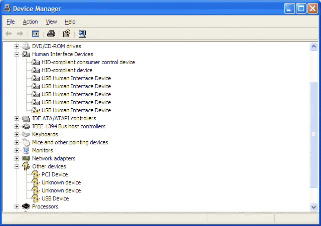

3. Look in Device Manager to see if there are any errors against your DVD/CD-ROM drive.
Start -> Right-Click My Computer -> Properties -> Hardware -> Device Manager - expand DVD/CD-ROM Drives and check the status. If there is an Error Code or a yellow triangle with a ! or ? come back here with the number and we may be able to help.

Posted by walms at 06-Jan-2007 17:44:34
Re: IF YOU HAVE DVD/CD DRIVE PROBLEMS - READ THIS>
Hi guys,
I have read all through this thread, and have not really come up with much.
I recieved my ne VGN-FE31Z yesterday, and after watching a DVD yesterday, and burning my recovery discs this morning, it now won't work!
I have a Matshita DVD-RAM UJ-850S, that is apparently upto date with the drivers!
But the thing doesn't work and is shrieked in the device manager, i've obviously unistalled it and re-installed it, but it doesn't work!
Does anyone else have this drive/problem?? Everything on the system is standard i've only installed, mozilla, macromedia dreamweaver, fireworks, flash etc. Itunes and Photoshop CS2! so nothing crazy!
Do sony take long to reply using e-support, i entered the info in about 2 hours ago.
Thanks guys
Posted by walms at 06-Jan-2007 17:49:12
forgot to mention
sorry i forgot to mention
in device description this is what is said, seems different to others codes?
"Windows cannot load the device driver for this hardware. The driver may be corrupted or missing. (Code 39)"
thanks
Posted by dejj at 06-Jan-2007 19:42:10
i had the problem with my sony FE31H and it not reading CD-ROMS, would read and write everything else. my vaio stopped working after about 2 months.
sent it off and i got another drive put in by sony, i've got a pioneer DVD-RW DVR-K16M now fitted and i had the matSHITa drive fitted before, really disappointed in the volatility of the vaio and i'm comtemplating investing in the extended warranty before october this year
Posted by Blencogo at 06-Jan-2007 20:35:38
ERROR CODE 39 IN DEVICE MANAGER
Hi walms - I think you are in luck!!!
A small Registry edit will fix your problem. Be careful and don't change anything else while you are in the Registry.
1.Click Start > Run and type REGEDIT and hit enter.
2. Navigate to –
HKEY_LOCAL_MACHINE\SYSTEM\CurrentControlSet\Control\Class\{4D36E965-E325-11CE-BFC1-08002BE10318}
and highlight it. Then locate UpperFilters in the right hand window, (if it exists) right click on this and select Delete and then OK.
3. Under the same Registry Key locate LowerFilters, (if it exists) right click on this and select Delete and then OK.
4. Quit Registry Editor and re-boot the computer, new registry values will be created that will hopefully cure the problem.
After you remove the Upperfilters value and the Lowerfilters value, you may possibly need to re-install your burning software – but not necessarily.
Welcome to Club Vaio and Good Luck !

Posted by jlmerino at 07-Jan-2007 18:28:55
Hi.Do you know if is there any update firmware for sony DW-u54a?
Thank you very much!!
Posted by walms at 07-Jan-2007 19:08:37
Re: ERROR CODE 39 IN DEVICE MANAGER
Hey,
Thanks, that worked a treat! Do you know why it happend/happens???? Thanks a lot, i thought i may have to send it back!
cheers
Posted by Thalamus at 07-Jan-2007 19:15:27
Hi jlmerino,
Could you let us know what model Vaio do you have please... confused
Thalamus
If we have helped you on the forum, show your support,
by becoming a Fan on our Facebook page
Club VAIO Experts
Posted by Blencogo at 07-Jan-2007 20:09:45
The UpperFilters and LowerFilters keys in the Windows registry store information about CD and DVD burning drivers. When you add or remove CD and DVD burning applications, these registry keys are altered and they can become corrupted. When you remove the registry keys and restart the computer, Windows refreshes the keys. Some applications may use a different burning driver than the application you reinstalled. If the other CD or DVD burning applications installed on your computer cannot access the drive after Windows refreshes the registry keys, you will need to reinstall those applications before they can access the drive.
Adobe Photoshop Plugins and Roxio/Nero are the common culprits.

Hi dogma43 and wecome to Club Vaio
When I look into the properties of the drive (in the device manager), it says: Code 41
The solution to your problem is the same as for walms 'Error Code 39 in Device Manager.
If you follow the instructions to remove the values in the UpperFilters and LowerFilters, it should fix your drive also.
This will also work if anyone has any of these Error Codes: -
Error Codes 19, 31, 32, 39 or 41
wink

i've lost my dvd/cd drive. When I go to the device Manager, there is a yellow ! on it. The model is a MATSHITA UJ-850S for VGN-FE31H.
Reading on the Internet, I found the problem could come after i deleted "Norton Ghost".
I cant' find the good driver on the Internet... Please please help me !!
I have my Sony since yesterday, so i don't already create the recovery kit !!!
Hep me please
thank you
Posted by Blencogo at 11-Feb-2007 19:49:42
Hi Audrey17 and welcome to Club Vaio.
Double-Click on the drive in Device Manager and tell us what it says including the error code.

Posted by obbie at 17-Mar-2007 16:11:03
Thanks Thalamus - Ihave followed these instructions & my drive is now available. Any idea what causes this error to ocur, as the driver is obviously not corrupted as it now works OK
cheers
obbie
smile
Posted by Thalamus at 18-Mar-2007 13:41:34
cool You're welcome obbie.. smile
The reason the problem occurred is usually due to a burning program being removed but I guess it could be any number of reasons.. confused

Posted by Rich912 at 22-Apr-2007 19:31:01
Hi caloira and welcome to the forum.
Have you followed Thalamus's link above?
In essence this refers to CD error codes 19, 31, 32, 37 or 39
If Device Manager is reporting an error code of 19, 31, 32, 37 or 39 then it is probably a registry problem. I recommend that you backup your registry before proceeding, have a look here if you are unfamiliar with this.
Then:
1.Click Start > Run and type: REGEDIT , and hit enter.
2. Navigate to - HKEY_LOCAL_MACHINE\SYSTEM\CurrentControlSet\Control\Class\{4D36E965-E325-11CE-BFC1-08002BE10318} and locate UpperFilters, (if available) right click on this and select Delete and then OK.
3. Under the same Registry Key locate LowerFilters, (if available) right click on this and select Delete and then OK.
4. Quit Registry Editor and re-boot the computer, new registry values will be created.
EDIT: Just realized that your machine is running under Vista. You therefore need to type 'Regedit' into the search area after clicking the Start pebble...

i'm getting the following error with my DVD/CD DRIVE. This device cannot start. (Code 10)
any ideas?
Posted by Blencogo at 05-May-2007 19:52:30
Hi reddzer.
This is the 'catch all' error code produced by the operating system when it hasn't a clue what the problem is and the drive just does not work.
The most common cause is because the IDE cable to the drive has become disconnected but it could be any hardware fault. As it is almost certainly hardware - just check that the read head in the drive is not sticking. Make sure it slides for the full range of its travel.
Your drive will have to be looked at/replaced so I would phone Sony Vaio-Link Support for guidance. They will probably ask you to carry our a full System Recovery before accepting the Vaio for inspection/repair - so get your data backed up!!!
Sorry it's not good news!

Please double-click on the device in Device Manager and tell us what the Error Message is?

Vaio VGN-C2Z/B
Hi everybody!
I've been reading all the threads and I have a similar problem with my dvd drive.
One of these days I noticed that tere wasn´t any dvd drive in my computer, I tried to read a dvd and it didn´t work, after looking in all the places I coulde imagine, I didn´t find the drivers for my dvd drive (DVD-RW Pioneer K17).
Could you help my find them?or find a solution for my problem?I read that one of you had this problem due to a disconnection of the the drive after some use, the laptop didn´t left home yet, I´ve been very carefull, but one of these days when I was opening it, it slided and hit the table with some strength, could it be from this?
I aprecciate all the help I can get.
Posted by Rich912 at 06-Jun-2007 12:46:38
Re: Vaio VGN-C2Z/B
Hi AdrianoF,
Have you tried Blencogo's suggestion?
Rich
Go n-eiri an bothar leat…
Posted by AdrianoF at 07-Jun-2007 20:39:43
Re: Vaio VGN-C2Z/B
Hi, it says that the configuration definitions are incomplete or danified in the registry (code 19).
Thanks
Posted by Thalamus at 10-Jun-2007 14:30:54
Re: Vaio VGN-C2Z/B
Hi AdrianoF,
You need to delete the UpperFilters and LowerFilters registry values, see MS kb314060 and follow the Manual steps to delete the UpperFilters and LowerFilters.. smile
Thalamus

hi blencogo thanks for the welcoming
i jus tried wat you said but there is no DVD/CD-ROM drives to expand!!!
do you have any other suggestions? lol tongue
thanks for your help!

Hi donovani,
do you have any unknown devices listed..
Thalamus

Posted by donovani at 09-Feb-2008 21:01:42
hey thalamus!!
do you mean when i log in 2 my laptop?
where can i find such a list???
hey thalamus!!
Have a look in Device Manager (see image below, the image below is from XP but Vista device manger will be very similar..).?
Press the windows key+R to open the Run box, then type devmgmt.msc and click ok..

Posted by donovani at 10-Feb-2008 00:39:07
hey thalamus
am sorry for bugging you like this! and i appreciate your help!
when i expand that HID section all i get is 'sony notebookcontrol device'
i opened up the run box and typed devmgmt.msc like you said. all that happens is new device manager windows open up!
do you think i should consider system restore??? confused
Posted by Thalamus at 10-Feb-2008 01:16:04
hey thalamus
Do you have any other devices listed.?
Attachment other devices.JPG (19939 bytes) (Download Count: 31783)

Posted by donovani at 10-Feb-2008 22:39:16
hi
it doesnt show any other devices

Posted by mrbrown18 at 04-Jun-2008 20:01:51
hi there...
i have problem with my vaio N31S DVD/CD Rom drive, theres a yellow triangle with a !,
theres a code error number - Code 39 when i view it in the device manager...
any chance you can help me with this?
Posted by Thalamus at 04-Jun-2008 20:11:20
Hi mrbrown18
Welcome to Club vaio, smile
There is a fix for XP provided by Microsoft , see below, but it's been used to fix the same problem on Vista..
It would be wise to back up your registry first, here is a GUIDE
Manual steps to delete the UpperFilters and LowerFilters registry values that can cause CD access problems
Warning Serious problems might occur if you modify the registry incorrectly by using Registry Editor or by using another method. These problems might require that you reinstall your operating system. Microsoft cannot guarantee that these problems can be solved. Modify the registry at your own risk.
To manually delete the UpperFilters and LowerFilters registry values, follow these steps:
1. Start Registry Editor (Regedt32.exe).
2. Locate the UpperFilters value under the following key in the registry:
3. On the Edit menu, click Delete, and then click OK.
4. Locate the LowerFilters value under the same key in the registry:
5. On the Edit menu, click Delete, and then click OK.
6. Quit Registry Editor.
NOTE: After you remove the Upperfilters value and the Lowerfilters value, if you notice lost functionality in a particular program, such as CD recording software, you may need to reinstall that software. If the problem recurs, consult with the software vendor for assistance.
7. Restart your computer.
or
alternatively save the CD Gone registry fix (attached below) to your hard drive and then double click to run..
Attachment cdgone.reg (418 bytes) (Download Count: 1530)

Posted by Thalamus at 14-Oct-2008 17:09:43
Hi guitardeejay,
just a thought but do you have any unknown or hidden devices listed in device manager.?

Posted by guitardeejay at 14-Oct-2008 19:47:57
Hi Thalamus,
I had a look in Device Manager and viewed hidden devices, there is a long list but only one has an exclamation mark on it "PCLEPCI". I don't know what device this is but the does say that device is not present (Code 24).
Any ideas?

Posted by JoeMs at 25-Jan-2009 16:29:18
My matshita bd-mlt uj-220s ata Bluray drive does not work and in the device manager i get this message
Windows cannot start this hardware device because its configuration information (in the registry) is incomplete or damaged. (Code 19)
Click 'Check for solutions' to send data about this device to Microsoft and to see if there is a solution available.
Here is a screenshot:
Posted by Thalamus at 25-Jan-2009 18:18:30
Hi JoeMs,
welcome to Club VAIO.. smile
The following guide below should hopefully fix the problem..
Warning other problems might occur if you modify the registry incorrectly. These problems might require that you reinstall your operating system. Modify the registry at your own risk.
First open the registry editor..
Press the windows key and the R key to open the Run box.
Then type Regedit in to the Run Box then click OK..
Press continue on the UAC window and the registry editor should open..
Restart your Vaio.
or
Attachment cdgone.reg (418 bytes) (Download Count: 1148)

Hi everyone,I have a vaio vgn fe31H..and it can read and play a cd and dvd but it stopped burning..i haven't tried anything like reinstall it because i don't know what to do..i also have PIONEER DVDR K16M..so what should i do?
If you go back to the very front of this thread - the first post gives you various tips including how to uninstall and re-install devices.
